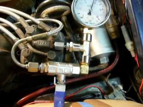

Tu as les pressions ici:
http://www.passiongolfgti.com/article.p ... D360B9D2EC
